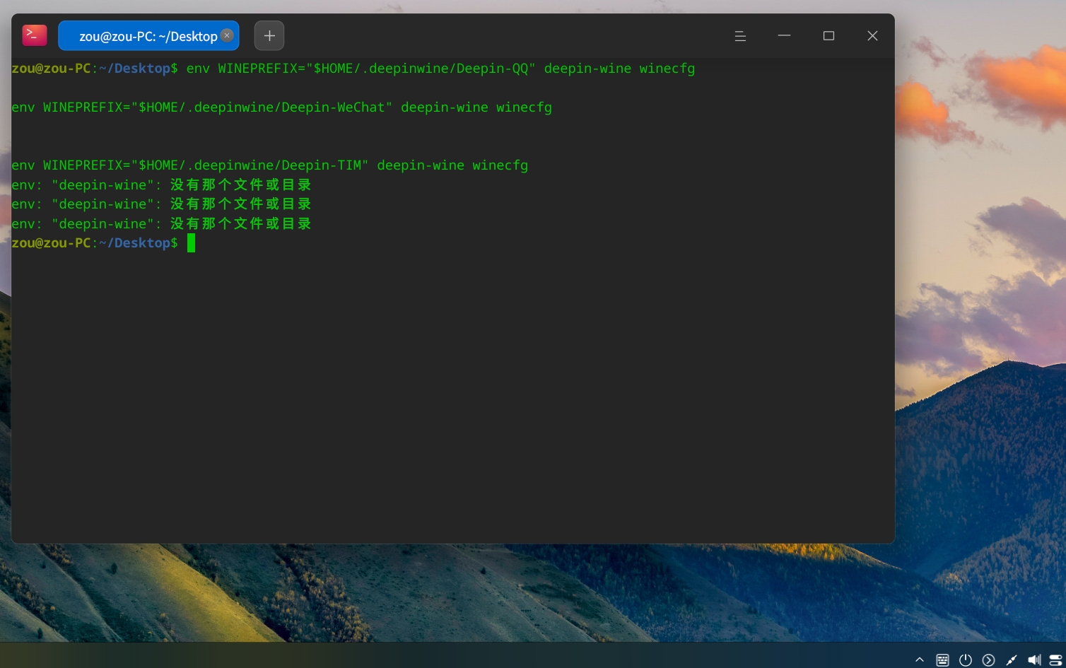

env WINEPREFIX="$HOME/.deepinwine/Deepin-QQ" deepin-wine winecfg
env WINEPREFIX="$HOME/.deepinwine/Deepin-WeChat" deepin-wine winecfg
env WINEPREFIX="$HOME/.deepinwine/Deepin-TIM" deepin-wine winecfg
打开终端分别输入以上代码,里面是微信 QQ TIM的缩放问题
你想放大多少,比如说你系统是放大1.5倍的,那么dpi就需要设置为144
自己按照原来默认的96去乘放大倍数就行就是在显示里面设置
